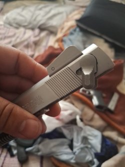

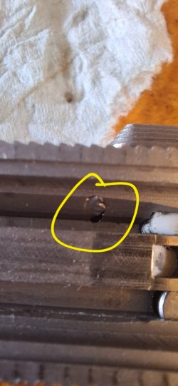

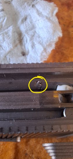

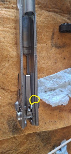

So I just purchased a used 5906 and decided to clean her up. While cleaning I noticed the small hole as viewed in the photos. It doesn't look like the hole protudes all the way through. The hole looks fairly small (small enough to where i cannot get a tooth pick in) Does anyone know if this would still be safe to shoot? or should I try to find another slide (as hard to find as they may be).
Any input is much appreciated.

Could have been a small slag inclusion in the bar stock where the slag worked it's way out after machining. Or a repair of same. It's not in a critical area so it doesn't really pose a problem. However, if it really bothers you, you might have the defect micro-welded up. There have been several threads on the process here. Or, try to find another slide.
