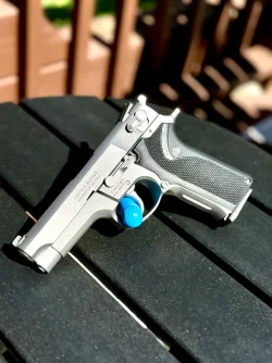

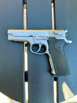

Hey all - new member here and first time 5906 owner.
Finally picked up a 5906 - not sure why I waited so long.
Bought one sight unseen - trusted the seller. Gun is in great shape and the serial number turned out the be my birthday! Pretty cool.

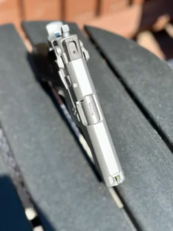

This is a wide hood barrel version - barrel appears to have been shot a bit.
I'm desperate to find a replacement barrel and cannot find a single spot that has them. Does anyone know where I can look or maybe order a custom barrel?
