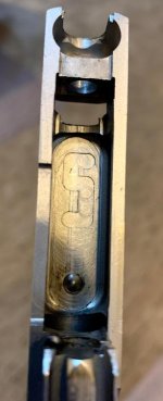

The slide on all 622's is stainless.
See below, the slide from a 622, and from a 622VR, the 422 and 2214 do not have the "S" marked on the bottom of the slide.
I had noticed the difference in marking from Springfield to Houlton. I brought this up and someone contributed that they worked in Houlton in the timeframe, and never saw these pistols manufactured there. I've never been able to find any doc that indicates they were made there.
