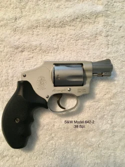

The secret to shooting J-frames accurately is practice, practice, practice! My 642-2 is very easy to shoot and accurate out beyond 20 yards, but my normal practice distance is 7 yards. At the shorter distances, I forget about the sights and practice point shooting. My EDC is intended to only be a "fire extinguisher" and get me out of a tough spot, not keep me engaged in some type of extended gun fight. I typically practice with Winchester 130 gr FMJ or Federal 158 gr. Nyclad RN...and finish up with a few Federal Hydra-Shok 110 gr. JHP. When I EDC, the 642-2 has the 110 gr JHP Hydra-Shok along with a spare Speed Strip. But to be honest, I've began to EDC with my PC Shield Plus 9mm. It's the same size as the Airweight, fits in the same Sticky pocket holster, but gives me many more rounds of 9mm HPs and is easier to shoot. Just my 2 cents.

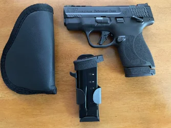

I move between my 642-1 and the shield plus myself. The shield plus is much more effective past spitting distance. Two fine pistols with different capabilities/parameters

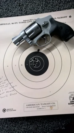

My 642 like all my 38 Specials shoots up to my limited capabilities with a Speer 158 grain swaged SWCHP with 4.7 grains of Unique. I practice at my local gun club indoor range at 25 feet. You got to really concentrate on your sight picture and trigger squeeze but the little S&W snubbies will shoot.
