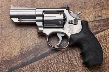

I had always thought I was a Colt revolver guy but after picking up my first S&W this week I now realize the error of my ways. I already love this gun. It looks great, feels great in the hand, and the SA trigger is wonderful.
It came with these grips on it but I’m wondering what it would have shipped from the factory with. I believe it’s an Ashland gun (AHL prefix) if that matters. Would it just have had round butt magna grips? Is there a trick to finding period-correct stocks for it? Thanks in advance.

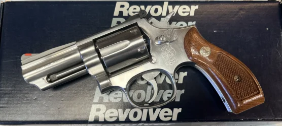

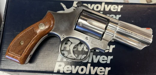

So the 3” Ashland guns have the round butt, target rear sight, and longer ejector rod - was anything else non-standard about them compared to other 66-2s? The smooth-faced trigger?
All Model 66's have a target (adjustable) rear sight. Does yours have a white outline rear?
Like the 2.5" version, the 3" have a round butt whereas the 4" & 6" have a square butt.
The smooth, .312" wide 'combat trigger' became standard on model 66-2's (except the 6") in 1982.
The 3" have the longer ejector rod not found on the 2.5" but also used on the 4" & 6" versions.
Besides the 3" barrel, I guess the only other thing non-standard is that the front sight blade is pinned to the base (which is integral to the rib). By that time all other versions had sights integral to the barrel.
That is a super nice revolver, we are all envious. Those stocks on it now are Hogue Bantam grips, I have them on my 64-2 and love them. Large enough for adequate grip but not too big for carry. Your setup is nice for sure.
