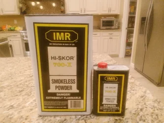

Scored some free 700x from a guy that shoots bullseye with me it's about 5 lbs total and I got three or four pounds a few months ago from another guy I know. I hear it's pretty good in the 45 bullseye loads might give it a try.
He says he has another 10 lbs he might give me so if it shoots good I can get a few seasons of shooting out of it depending. I'm currently using N310 and I still have probably 12 pounds of BE left.
The N310 shoots extremely well In my guns and runs really clean compared to the BE.

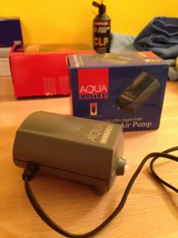

It is a good pistol powder once you get it in the case but did not meter well for me in CH or Dillon. I ended up with a vibrator (cheap aquarium air pump) on the powder measure to shake a reasonably uniform load into the bar.
