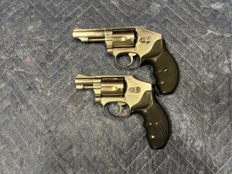

I don't have a handle on current pricing, but I've had a 940 for several years. The chambers are like glass, but extraction with +P ammo is still sticky. Moon clips are required for proper headspacing. Otherwise, headspace is grossly excessive.
Good part is that 9mm ammo is surprisingly efficient in the little 2" and 3" guns. Ballistics in a 2" 940 often approximate those of a 4" semi-auto. Overall, I like the little 940, and other 9mm revolvers.

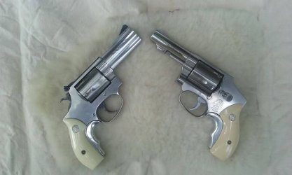

Here is a manufacturer's image of before and after using one on a cylinder chamber that is in worse condition than what we are looking at on the Model 940s
