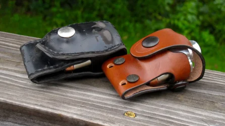

However, back when I had the mourned customized no-dash 940, I used a small amber prescription bottle that held two loaded clips perfectly and didn't bulge too much in my front left jeans pocket. I could scoop the bottle out and jiggle it in front of the 940's open cylinder to get the rounds lined up to fall into the chambers. Again, the solid hold of the Ranch Products moon clips really made this work - no jiggle to the rounds (unlike the awful design of the new model Ruger SP101 moons for the newer 9x19s like mine).
Nevertheless, my pill-bottle method wasn't especially fast. If I had a moon clip in my hand, I could load quicker than a duck on a junebug (as mentioned up-thread), but that's not how it was with the clips in the pill bottle.
Comparing apples and oranges (having utilized both the Fraurem loader with my jiggly SP101 moons and the pill bottle method with the 940's solid ones), I'd say I load with about the same in subjective speed - but obviously I no longer have the 940 (and it's been years), so this is just the memory of an old man. The Fraurem R9S loader is a little wider in the pocket than the pill bottle but there's no way to keep lint and crud out of the pill bottle unless you use the lid or a balloon . . . and doing so would make it a whole lot slower than the Fraurem.
Also, with the R9S one is able to control and rotate the rounds to fit the chambers . . . so I think if one were comparing apples to apples (the 940 moon clips from a pill bottle vs. the same 940 moon clips from the Fraurem loader), the loader would be faster. However, for a practiced individual with solid 940 moon clips, a clip in the left hand is as fast as it gets. Great if you're at the range - probably not how you'd walk around the office. ;)

Did you look at 35 mm film canister for the 940? I know it works for LCR and permits to open it with your thumb (modern pill bottles have child-resistant caps that must be pressed twisted).
Never did that I can recall, but you've got me running out to the garage to grab one to try with the SP101 . . .
...there's no way to keep lint and crud out of the pill bottle unless you use the lid or a balloon . . . and doing so would make it a whole lot slower than the Fraurem.
You can actually get a non-child proof lid for any Rx medication container just by asking at the pharmacy counter. Most just pop right off with a thumb just like a film canister top but with the added advantage that they hold two loaded clips instead of just one with a half inch of "rattle space."
The advantages of the R2S holder is that it gives you a perfect handle for aligning the cartridges with the cylinder as well as a no-rattle unit to put in your pocket.

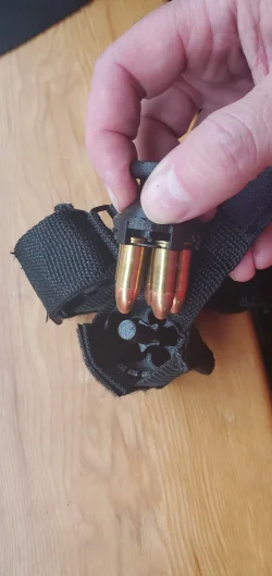

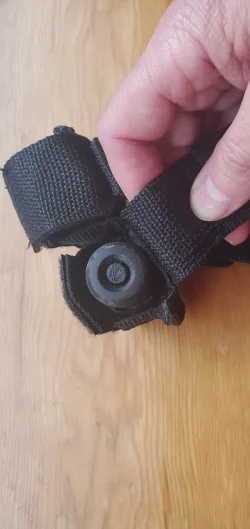

My speedloaders arrived today and I tried them in a nylon shoulder rig. A very snug fit which is nice, so when releasing the loader the housing stays in the pouch. Loading the cylinder works just as advertised. :)
OP, looking forward to more reviews as you get used to the new hardware. I will probably stick with factory 9mm ammo for now, although I did pick up a few boxes of .380 to see how that goes. Supposed to work just fine, but best not to be carried for defensive purposes.
Todd
