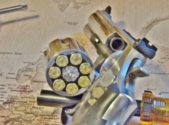

S&W has a 9mm J-frame out now if you want to go smaller. I built a "9640" years ago by fitting a factory 940 cylinder to a 640 Centennial. It's a really neat little gun.
Yes, it certainly can be done. TK custom and likely others can machine a cylinder to accommodate the 9mm cartridge and moon clips. I had another gunsmith convert a 686 cylinder to 9mm with moon clips.
