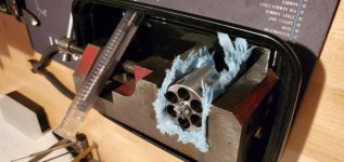

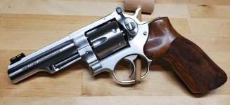

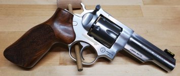

That went a wee faster than the last time, I wasn't as nervous this time around I guess...
Took chambers to 1.155...
I will probably shoot her tomorrow as I only have 4 10mags leftover from the last time, so time to make more...
Yes I punched the other 2 chambers lol...

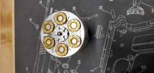

In looking at picture #2 in post #8 it appears as though a couple of the cases in the moonclip are sitting high, i.e., the rim of the brass is not touching the moonclip as there's a gap between them, possibly due to your ream to depth??
For my "ream to depth" I decided on 1.163".
As my factory S&W 610's 10mm Auto chambers measured .900" from the chamber ledge to the face of the cylinder, and the 10MAG's max case length is .263" longer than the 10Auto (.992" -vs- 1.255"), so 1.163" sounded right.
If you want to be able to shoot the 10MAGs without moonclips casually (which I like to do), this "ream to depth" is important.
If you're always going to use moonclips any length longer will work.
A shorter length means you'll have less shell head clearance.
10MAG case length ranges from 1.245" to 1.255", affecting shell head clearance w/o moonclips.
A mid-length (1.250") 10MAG case should extend .087" above the cylinder face & give ~.017" shell head clearance.

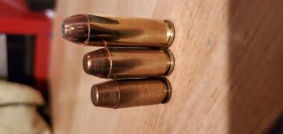

Loaded with Zero 165gr JHP bullets
Before reaming to 10MAG
10MAG loads
