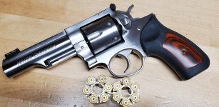

First round of testing is in...
I went off Tafitins writings and started at 18gr of 2400, with a 12 shot average 1380fps in 80* weather out of the 4 inch GP100 match champ runing xtream 200gr FPs
Surprisingly accurate, shooting way high(sights need to be adjusted) but all within a 3in group at 15yds
My opinion is frigging WOW, what a cannon! I think some magnaporting may be in order....
Anyway that's all I have for now, next up will be H110 loadings :D
Edit add, I neglected to mention that the cases fell out of the cylinder so I think that's a great sign.
