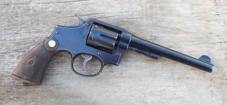

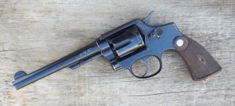

I'm not certain as to the relative rarity of a 6" barrel on one of these. This example has retained most of its factory blued finish. The stocks exhibit some wear but are original. The chambering hasn't been altered.
Serial number 7450XX. My database shows British Service Revolvers in that range as having been shipped in March of 1941.

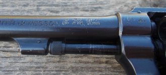

Marked with a broad arrow embedded within a "C". I take the slash overstamp as signifying its having been sold off as surplus. It bears typical British commercial proof marks that would've been applied to a firearm before it was released into the civilian marketplace.. On the opposite side of the barrel near the frame is stamped "38/380". According to my research, the crown over "BNP" (Birmingham) stamp didn't come into use until 1954.

There are BSRs with the 6" barrel known in that early serial range. S&W was providing revolvers from inventory as fast as they could to satisfy the British demand, given that they were already paid for under the unfulfilled submachine gun contract. I have no information on the number of them, so I can't verify the "rarity." But I don't think the number is tiny. Weren't there some 6" units that went to South Africa? Charlie would probably know.
Hi Jack:
I am not aware of any 6 inch guns shipped to South Africa. A quick peek at the Victory Database does not show any either. The SA guns were 4 inch guns.
There were a substantial number of 6 inch guns that were purchased by the British Purchasing Commission. I would not consider a 6 inch, .38-200 pre-Victory to be rare or even scarce.
Regards,
Charlie

The first 14000 odd SA guns were 4". On placing a further order S&W said that they were only now making 5" (for Britain obviously), but that SA's spares would still fit. 7500 5" were ordered and delivered, still to full commercial finish and grips. All subsequent SA guns were Lend Lease and obtained via the London Munitions Assignments Board. Final total just under 27000.
Peter
The 38/380 was only supposed to be stamped on guns that had been reamed out, but some people got over-enthusiastic with the stamps.
My understanding is that the British terminology for their version of the .38 S&W cartridge was .38/200 and later .380 Revolver MkIIz when loaded with a 178 grain jacketed bullet. Thus, I'd take the 38/380 stamp as indicating the revolver retained its original military chambering, which in fact my example does.
The British terminology was Cartridge S.A. Ball Revolver .380" Mark I and Mark Iz for the 200 grain bullet (z=nitrocellulose propellant). The 178 grain was as above, but II and IIz.
38/200 was the headstamp used by Kynoch (and possibly others) for a 200 grain commercial round.
The 38/380 stamp was a part of a rather complex scheme to easily identify the chambering of the range of revolvers aquired from the USA in the early part of the War (1939-45).
Peter
Commonwealth military ammunition boxes were label stamped in several ways, all were variations of .380 Mark I or Mark II. Never .38/200 or .38 S&W. The British official nomenclature for the revolver itself was "Pistol, Revolver, Smith and Wesson, No. 2" No. 2 indicated .380 caliber, not .455. .38/200 was not official Commonwealth military nomenclature for the revolver or its ammunition, although S&W unofficially used it.

I have one that also is a 6" barrel. Mine was shipped in February 1941, has the Canadian proof mark without a slash through it, barrel stamped 38/380. No import stamping anywhere. Still has the lanyard loop,original stocks were removed and replaced with a pair of shrunken Franzites.
Interesting thing, Roy stated the gun left the factory with a 5" barrel, mine is a 6" barrel and on the underside above the ejection rod the serial number is stamped and matches the number stamped on the butt. I need to letter this gun.
