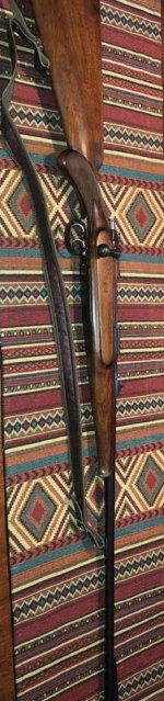

First a JP Sauer & Son in 9x57, a factory built sporter, equipped with a Lyman 35 rear sight.

I gave it a try.
What I (think) know about the rifle is that is was built around 1905-1910
On a Oberndorff M98 action that was sourced from Mauser by JP Sauer to build into a sporting rifle, that is it was never a military 98. It was built for the American market for a retailer such as VL&D or VL&A in NYC and Chicago respectively or a similar retailer such as A&F.
It seems original and unmolested, although I am not certain if the leather faced recoil pad is original. If not it is not it has been on the rifle for a very long time. It also has an externally adjustable trigger, but not a set trigger.
The barrel starts as an octagonal barrel that is swamped into a round barrel with a rib.

Beautiful! I love those Pre-war sporters. Mine is 8x57J with a Lyman aperture mounted on the right side of the receiver and with a front claw mount. It kicks!

Dude, your rifles look amazing, the Sauer is a beauty in every way, and the other Mauser action rifle has something that I really like and it's the double trigger, thanks for sharing and congratulations.

That JP Sauer is a beauty.
Are you sure that trigger on the Sauer isn't a Single Set Trigger ?
It looks like it in the pics.
If in operating condition, you should be able to push the trigger forward by pushing on the backside of the trigger shoe. It'll rotate forward and 'click' in the forward position.
That's the 'Set Position'.
Then a light pull will flip the trigger rearward and kick the sear out of engagement and drop the striker.
The small screw is used to adjust the trigger pull up and down. The further the screw is turned 'in' the lighter the pull.
Single set triggers were never as popular as the double set style and they never give you quite the same light let-off. But they were a Mauser option and offered by most all the European makers of the day.

The Sauer is a NICE piece.
Trigger- Did you check to see if that is a single set trigger? Push it forward and see if it sets.
I doubt the leather pad is original. What is the LOP?
Your other rifle is a cut above the average "subsistence" grade of guns built by gunsmiths just to make a few marks for a loaf of bread and a potato. But you probably already know that. I wish you had more pics. I would expect that gun to have been rust blued. Do you know if it has been redone?
It maybe be a single set trigger that is not functioning properly, I need to take it out of the stock and take a look at it. In the 9x57 I plan to shoot cast bullets, so the loads will be moderate, the moose are scare in WSTX :)
The Sauer's LOP is 14 1/4 to the end of the pad, and 13 1/2 to the end of the wood. If the pad was added it was done correctly and the curve of the butt was maintained and not cut straight across like so many pad jobs are.
The finish of Sauer is original, I believe. The receiver is similar to the old style Colt blue, it is shiney and really blue, the barrel and furniture is a more subdued rust blue. The 8x57 has been replied and sadly I see some pitting near the end of the barrel that wasn't filed out.

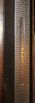

I forgot on the Sauer-
What makes you think it was built for the American market? I don't think so. Not a popular caliber here. 7mm or 8mm would have been a better seller. I could be wrong.
I also think that rifle is later than you think. Maybe late 20s, early 30s. That stock style just doesn't fit Pre WW I Germany, IMO, with the flatter pistol grip and lack of schnabel, but, again, I could be wrong.

The reason I believe it was for the American market is the Lyman 35, and the spelling of son, in JP Sauer & Son is the English version and not Sohn as I see on my other Sauers. The reason I believe it is pre-WWI is the take down wedge in the fore end, the octagonal to round type barrel, and the panels on the stock which seem to me to be early features.
The 9x57 had some popularlarity in the US and I recall Winchester chambered a few Model 54s in that cartridge.
When I take it out of the stock it may have some markings on the under side of the barrel that will help establish era of manufactor.
