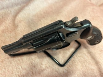

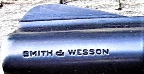

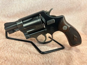

View attachment 772819View attachment 772820View attachment 772821View attachment 772822
This one is #30434. It has the short frame, round trigger guard, flat latch, serrated ramp sight and trigger. Matching frame and cylinder, grips numbered to a different gun.
I am curious as to when this Baby Chiefs Special was made (month/year), SCSW 4th seems to indicate early 1953 (number made, 28916, starting at 21343?).
Are these correct mini-Magna stocks? (besides being mis-matched, they do fit the short frame)
Are there any differences in stocks between Baby Chiefs and Terriers of that period?
Does this have a 2nd type flat latch?
Is this the "fine knurled early hammer"?
Any/all information would be appreciated… I can provide more info/pics if needed.

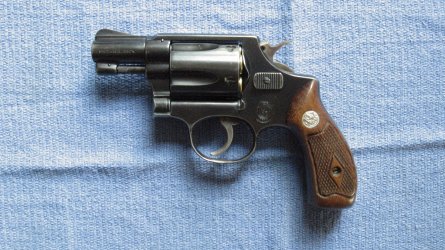

Mine is late 1950 serial 7349 it has same grips and knurled hammer. I think the grips are same as Terrier and basically I-frame grips.
