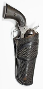

The best-known maker of the Brill, was Arno Brill (we think) who made the 'early' Brills (before 1930):

brill saa butch (1).jpg This one is marked on the backside of the fender as A.W. Brill, and alleged to have been owned by Butch Cassidy, though city directories indicate that neither A.W. Brill Company nor Butch Cassidy lived at the same time (1912 'birth' for the former, 1908 'death' for the latter). Some theorists believe that Butch was not killed in 1908 and actually died many years later in USA.
