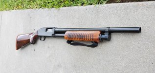

Howdy,
Every one in a while ill stumble across a deal to good to pass up and it just so happens last Friday I get a call from my pops about a fella trying to sell his old bird gun. I told pops to get some pictures and I got to thanking..
Turned out to be an old I would say late 50s/60s/maybe 70s JC Higgins model 20, 12ga 28in bbl. Dident get much of a picture, but I figured how bad could it be... right ?
Well I go take a look at it and it looked like it got kicked around a closet for about 20 years judging buy the dried oil shut chamber, the banged up stocks and the amount of dust all over it..
I take the gun toss it in the cab of the truck and head home... Every right, every left I make I hear something moving around in the gun???? Turns out it still had the original shell dowel in the tube, cool right ?
I get her home and get to work stripping her to bare bones and giving her a good Rem Oil soak. While everything is soaking I measured the business end and marked where she needed to be cut, out comes the grinder.... Zipped right threw it at 18.25in finished the rest off with some hand files... cleaned all the parts off with 0000 steel wool and brought that bright bluing back out. Turned out to have a jeweled bolt and shell lifter.
After I put the metal back together I went to work on the stocks... I started with 60gr and worked my way up to 2500 soaking in between each sand,working the dings out, then air drying over night inside before applying oil (Tru oil) gave her a good 7 coats nothing crazy applying with the finger just filling in until some what glossy. Some deeper pores still show, but I'm not concerned with that given she will be my beat around truck gun(dident want a nice rifle in the truck:eek:).
I've done this all before on an old Stevens 311 SXS, never on a pump gun. I have to say I'm pretty proud of it turned out pretty nice. Just have to get a gold bead kit from Brownells and she will be good.
I also had a strap left over from one of thoes shockwave shotguns[firearms]so I screwed that on her to finish her up...
She will be all nice and hardened up come the weekend for some T&E!
Thanks for letting me share guys
What CHA think ?
Erik

Did a great job in restoring. Friend had one in `12 gauge made by High Standard which was before Winchester started supplying them.
Sears model 20
I inherited a Sears Mod. 20 from my father-in-law. It is in great shape and also has the original magazine plug. I dug it up a few weeks ago and thought about reducing the barrel length, but it is really too nice to modify. It has one of the old style choke tubes actually soldered to the barrel. Willyboy
"Charlene" is an easy choice but maybe a bit too cliche. ...a la 'Full Metal Jacket'. I'm sure you'll come up with something that has more meaning to you. Enjoy.
Sent from my SCH-I545 using Tapatalk
Those old JC Higgins/High Standard pumps were great shotguns. I've got a JC Higgins 20 with vent rip and the "Pow'r Pac" choke. It's a skeet bird killing machine. Homely looking as all get out, but man does it shoot nice.
This one was a smooth bore, so no choke. If it had one I might have thought twice about wackin it off... hahahah lol
How about "Christine" like the old Stephen King movie?
Figuring I brought the ol' girl back to life....
I like that... I shall call her Christine !
