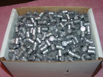

I looked on the Zero distributor, Rozeman and they didn't have any info on how they were lubed. The pictures appear to be wax-in-groove but they are vague. Is that how Zero swaged bullets are lubed?
Look at your favorite reload book and stay under 880fps. I do 3.1 Bullseye in my 3 autos. Some wad cutters are only lubed in the center lube groove. LOTS of shotgun powders work.
