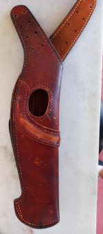

A mangled but none the less interesting A.W. Brill holster
Jun 3, 2022
396
1,345
Texas Hill Country

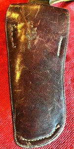

This holster was on a table of a friend in New Mexico. Note the unusual loop stitching 2 places on the back skirt of the holster. I have a number of Brill holsters and have not seen this stitch pattern before. Others may have...

You had me at 'Brill' :-).
Look again, the original stitchlines have been picked out and the ones you don't recognize were added, to create a wider belt loop. Not how Brills were equipped with wider loops; the fold was moved.
And you didn't notice the hack job of the holster pocket itself? All its retention has been cut away. It used to be a Kluge scabbard.

Yeah Red, you couldn’t miss the “Bubba” job on the holster pocket! I noticed it only having a single welt, being a Kluge holster. Obviously, Bubba didn’t care about the collectibility of this early Brill and ruined it, which should be a “hanging offense”!:eek: The only thing that could possibly make the alterations to the holster acceptable is if, like Tim said, it has a fantastic story behind it.
Larry
