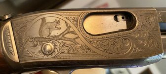

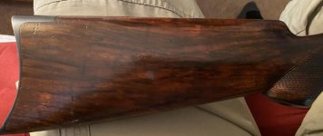

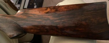

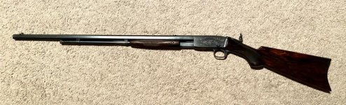

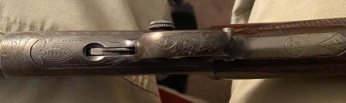

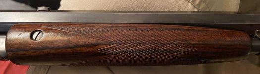

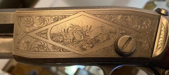

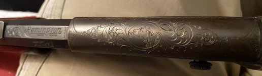

Hello from my home shelter. Hopefully things will open up a little next week. This situation does allow me time to start a thread on my F Grade Remington Model 12. This gun dates to 1912 based on the hand engraved serial number. This gun has been well cared for in the last 108 years but it has been used for what it was intended for. I can only imagine how proud the owner was after paying the large sum of $75.00 for this rifle and walking the fields and forests with pride of ownership of this rifle. Bill

A very beautiful firearm. It's a little funny in that I can think about buying that rifle 75 years ago and taking it out in the field to show it off to my hunting buddies but now I would be scared to scratch it. Oh what a difference 38,500 days make.
She is beautiful for sure. I wonder what something like that would cost today. It made me get out my Rem. mod.31. Nowheres near as ornate but special to me.

Remington made some fine looking high grade firearms, the Model 12 was not left out of the fun.
Best quality European Walnut stocks were used. Same engravers that cut their high grade repeating shotgun and rifles and had cut their SxS's were doing up these as well.
Joseph Loy was one of the best and did work for Remington as well as Parker and I believe Ithaca.
