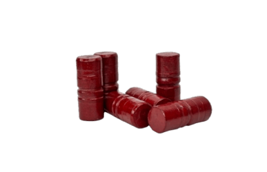

Acme 230gr 38 spl WFP
I never used them but I think they're so long you have to load them in .38 Special brass but they will fit only in .357 Magnum cylinders. I recall reading that Jerry Miculek used a similar bullet for pin shooting and they were loaded to very high pressures.

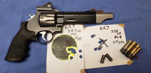

I you shooting them in 357 or 38 spl??
627 8 round 357 magnum V comp as pictured above. I do load them in 38 spl brass becouse it reloads faster.
I will check my data but I'm pretty sure I'm happy to get about 750-800 fps. I don't need to push them at full power to knock bowling pins back 3 feet.
