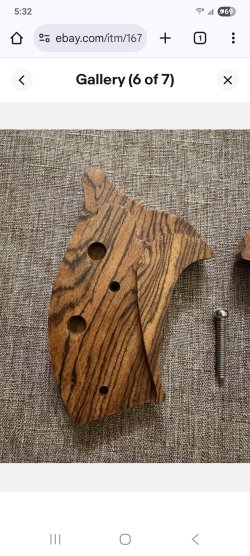

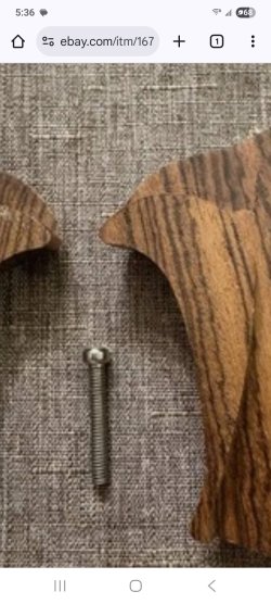

Sorry to raise this thread, but I'm not following the answer above. Do the ahrends n-frame grips use the stock s&w n frame screw?
Also, anyone want to sell me some smooth Tacticals? ;) Losing Kim was a shame as I found his smooth Tacticals to be a perfect fit for my hand.
I don't believe they are the same.
The Ahrends had the full length threads.
I also think the head was a tad bit bigger on the Ahrend model.
Now I don't know what the threads are so they may work but not the same.
I have one set of N frame. 5-40X7/8 stainless fillister and it could use a little more length. Not consistent with any other grip I am aware of.
