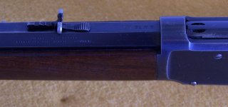

Here are the barrel markings on an early .32 Winchester Special. Note the smokeless Powder stamp.
This .38-55 shipped November 5, 1905, which is really close to the .32 Special above. You'll note that it also has the definitive Winchester proofs, but is not smokeless powder marked.
