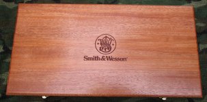

My own experience is somewhat like yours, but I've only had a few N Frames that had the wooden cases and of those one was refurbished with maroon liner to replace deteriorated flocking over plastic inserts. That is the one pictured for Model 27-2. It clearly had a darker grain than others but I don't know if it had been refinished. The one marked 29-2L is completely original and went with a 1980 Model 29-2. It too is darker than my other Model 29-2 completely original case (1979) which is the "light colored mahogany".

The only wood type I've seen in old advertisements for the S&W cases was mahogany. I've seen variations in the wood in cases but mahogany lumber used for cases came from the Honduras, Brazil, and Mexico. Another reference said some from Africa and Asia. I would expect variation in color, density and weight from the different locations just as there is with Walnut lumber from the northern U.S. vs. the southern U.S. I have some that are very light and plain and others that are dark with beautiful grain. All that said, NEVER SAY NEVER with S&W.
It's also a possibility that someone refinished the outside of the case and used some wood stain to darken it and bring out the grain. I've done that with a couple of presentation cases that were pretty beat up, like this 1973 Texas Ranger Commemorative case. After sanding and repairing I changed the stain color to what I thought was a more appropriate Texas post oak.

The mahogany presentation cases were made in S&W's carpentry shop. It is certainly possible a wood other than mahogany may have been used infrequently as a trial or just because that is what the shop had in stock.

I was referring to cases made in the 60s, 70s, and early 80s when the case being discussed was made. I realize S&W changed a lot of things over the years regarding manufacturing of accessories. The presentation case was discontinued as an accessory in 1985 so when S&W introduced the 29-10 in 2006 they contracted out the manufacturing of cases.

I have never seen a rosewood case.
Your case is the normal mahogany. It has been refinished.
