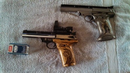

Never shot the Victory but I have 2 22As, a standard and a Talo. both take the same mags, but one mag is finicky and doesn't like to feed in the Talo. Works fine in the standard gun
