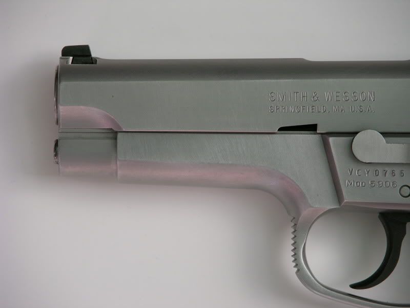

I had this one on a backstrap of a PD trade in gun. It did not turn out "perfect", but certainly a 110% improvement. This was done by file, Dremel, and progressive sanding and polishing.
