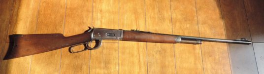

I have an old (1901) Winchester M94 that was my deer rifle for years. I don't really hunt anymore but would still like to shoot the rifle. I loaded up a bunch of low power plinking rounds that are pretty accurate. My problem is that my rear sight doesn't give me enough elevation. I'm thinking about a tang sight (Marble's or Lyman) but not sure if it will give me the elevation I need. Anyone here have any experience with one? What's your opinion?
