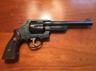

I sent my 38/44 HD 6 1/2” back about five years ago ( really surprised they agreed to blue it) and was mildly disappointed in the results.
I realized before I sent it it wouldn’t be the same bluing process as when it was made but had hoped it would come close.
I guess in the end it looks better than it did.View attachment 756121
Looks like they restamped the markings. Also reminds me of the finish on the M28.
