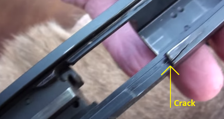

Here are the other two pictures. You can see the cracks pretty well in these.
Wow, that's a new one. Can you give us some details? Has anything unusual happened with the gun such as solvent exposure, unusually high pressure reloads, etc? Have you pistol whipped a bull rhino with the gun? :D
Let us know how S&W takes care of you. I am sure they will make it right.

Mine cracked today while at the range, or at least, it had a number of malfunctions today. While researching the malfunctions, I came across a different thread on this forum, describing the same problems that I was having. The poster found a crack between the trigger and the magazine release button. I checked my Shield .40, and there was the same crack . It was apparently allowing the frame to flex enough to allow the catch on the slide release to push the magazine over against the trigger draw bar, and prevent engagement with the sear.
The mythical frame crack that everyone in this thread agrees doesn't exist...exists. I'll be calling S&W tomorrow.

Wow sorry to hear that it does seem to be pretty rare to have that issue . Have any pictures of the crack I'm sure it would help a lot of folks out showing exactly were to look and also to remove and shadows of doubt .
All I have to say is........ [ame]https://www.youtube.com/watch?v=BI1V1CmFvMA[/ame]
No picture at the moment, but the crack is not in doubt, and extends between the trigger and the mag release button.
