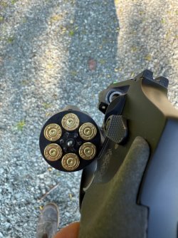

I actually just ordered 3 Apex Extended firing pins. I have one 432 UC and 2 632 UC's…the 432 is the one I've shot the most and it has been flawless with Buffalo Boar and PPU (S&W Long) but has a 10% failure to fire rate with Lost River Ammo. It looks like an adequate primer strike, and they always go off the second time. I can't explain it. In the attached photo the round at 12 O'Clock failed to fire and the indentation is practically identical to the others. Hoping the extended firing pins will give me an added sense of security. I love the gun and its my EDC!
