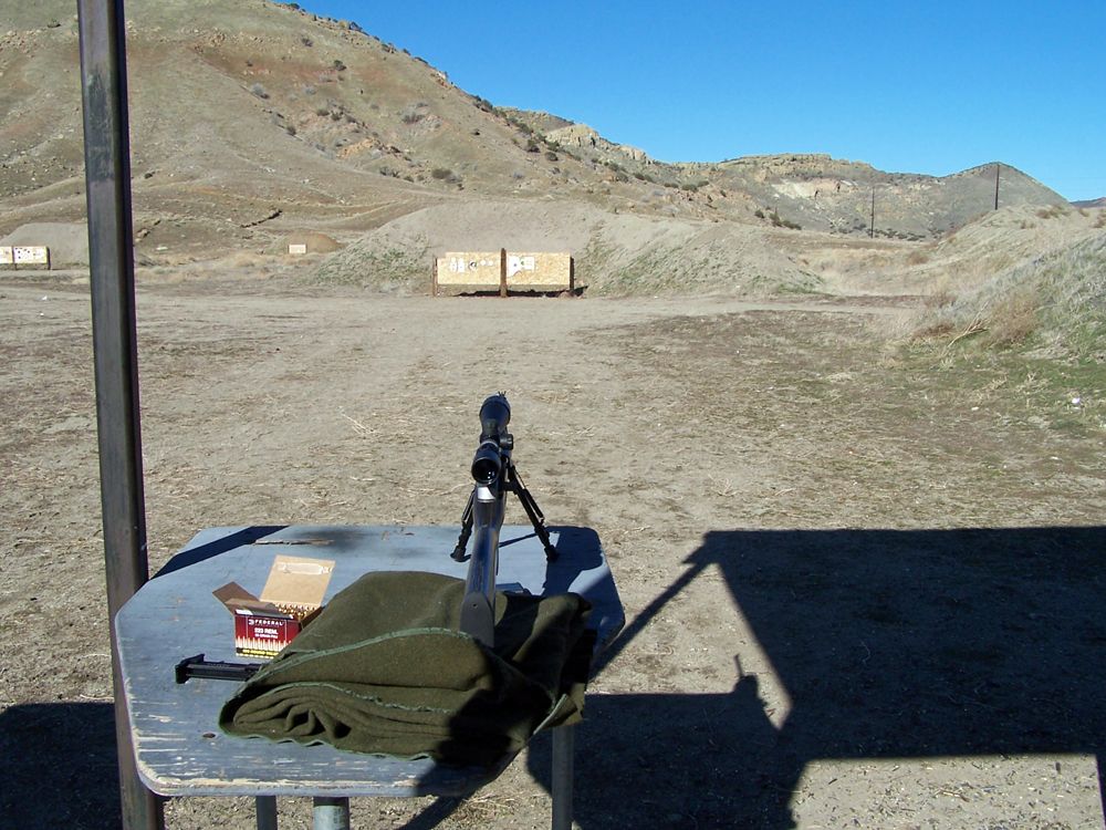

I made a painful discovery about the .223 once. When I was setting up this test:
I was excited to get rolling with the shooting. I forgot to put my ear plugs in. The first shot was painful. While this was not inside, it was under a cover. I can tell you that it felt much worse than any shotgun I've ever shot. I don't know why it was so painful, I just know it was.
