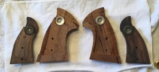

Are these ‘N’ Frame Grips
Mar 2, 2019
759
2,126
Carrollton GA
I bought two pairs of K Frame Target grips this week, or at least I thought i did, one set for a 1971 18-3 and the other for my 1978 19-3, both needed football cutout targets.
Pair 1 were purchased from a forum member and they are dead solid perfect, and have beautiful grain. Much too nice for the 18 shooter, real nice for my 3T 19-3.
Pair 2 were purchased from Flea Bay (yeah, yeah, I know, if the shoe fits, you probably didn’t buy them on E-Bay). When I put them on, there was a large and very evident gap front to rear. There’s also a gap on the top, front and back, but not as evident.
I suspect the seller just didn’t know, unless laid side by side, kind of hard to tell. I own more than 20 Smiths, but not an N Frame in the bunch. Maybe I need to get one for these nice grips...
Anyway, do you think these are N Frame smooth presentation grips?

I agree with weatherby! Those are K frame grips. N frame grips would stick out from the backstrap about 1/16" on a K frame gun. Just as K frame grips on a N frame would be 1/6" short of matching up with the backstrap. The routing on the inside doesn't matter because the pin at the base and the metal washer hold the grip in place.

Those are very nice presentation grips, and they may have a greater value than K grips. At least it’s the case for the combat grips.
I have one pair of K presentation grips (all others are combats) and I like them a lot

Not trying to be argumentative here, but I have several K frames, K22 (17&18), K32, K38, 686, the list goes on...and these grips don’t fit any of them. They are easily 1/8-1/4” longer than any of my other K frame target grips, and noticeably wider (front to rear).
I’m sure no expert, but if these are K frame grips, S&W sure messed these up. Here’s a couple of pictures, the first are the N? Grips on my 18, and the 2nd are known perfect fitting K frame grips on the same gun.

Really Confused Now...
I have a friend with a 629, he took the K/N grips home today and sent me some photos, they don’t appear to be a good fit on it either.
Looks like a factory second or some mistake in manufacturing, since they don’t fit correctly on the K or N Frame. Very odd, but just one of those things.

That’s exactly what K frame target stocks look like on an N frame. You have K frame stocks that are a bit proud. Use them as is or carefully fit them to your gun and blend in some finish.
Navy,
I thought they were K's from your initial pictures. The gaps and the small protrusion of wood at the top of the backstrap in your 3rd and 4th pictures are common on K frame targets, in my experience. It's a little frustrating to those of us who tend toward perfectionism, but I've gotten used to it.
The most evident proof from your pictures was the width(length?) of the 'shelf' behind the washer in your fifth picture. There's not a lot of difference between Ks and Ns at that point, but enough to be noticeable, and there isn't enough shelf there to be an N target.
As s&w chad pointed out, the grips pictured on the 629 remove all doubt.
If they were mine, I would put them on your gun and enjoy them -they look very nice.

You needed to get an N-frame anyway, so this was meant to be.
Given that you have a 19-3, try a 27 or 28 if you haven't already, just to see if the larger frame feels better - those grips would look great on either.
This pic makes me think they were originally N frame grips. There just isn't usually that much room in front of the grip strap---
Also, they look refinished to me.
So, one more possibility is that they ARE N frame grips that were heavily sanded by a novice refinisher,
OR,
someone has sanded down a pair of N grips to fit his K frame. Believe me, I have seen both of these ocurrences many times. ;)

Thank you Lee, and thank you all who have added very educational comments to help this old ‘grip novice’ out.
One thing is certain, they can’t be made larger to correctly fit an N Frame (see Pipe Stretcher logic). But it would seem they could be made smaller to fit on a K Frame by someone with such talents, probably not me.
As Handejector stated, that is a very big gap for something originally designed for the K. IMHO they are far too sloppy and loose as they are now on any of my K Frames, and at least to me, they feel very odd in the hand. Then again they are far too nice to just be stuck away in a drawer.
Is there anyone on the forum who does this kind of work?
Thank you all again for the comments, very much appreciated.
