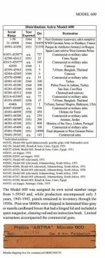

I'm attaching a table of what serial numbers went where. If the one you are going to see saw service in the German Army, it is practically being given away. Oh, check out online how much they are going for (the 300's, the 400's, and the 600's). You'll be surprised. Thank goodness there are a lot of people that don't know jack about them; its how we collectors get lucky..
