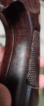

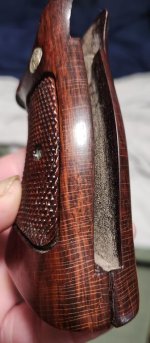

Figured some of you guys might like this..
I wound up with several really nice sets of grips where the original finish had become crazed.
It's been awhile since I've done any sets but Figured these would be worth the effort.
First 2 pictures show a badly crazed set.
3rd shows that set with a coat of tung oil and
another I just stripped.
4th shows the first coat of thu-oil on a previously stripped set.

Acetone is what I use to remove the old finish..
I generally just put them in a sealed metal can overnight and use a toothbrush..
The old finish come off easily this way.
Ditto this. After a day or two submerged in acetone the remaining original finish will wipe right off. A toothbrush works well to remove any remaining traces out of the checkering.
Just be aware that you have to clean them up immediately after taking them out of the acetone bath, because the acetone will evaporate VERY quickly and any remaining finish will re-harden as it evaporates.
That qualarenu sounds like a product I'd like to try thanks marksman for that tip.. I have a set or two that are just lightly crazed.
I actually tried to see if the acetone would soften the finish enough to blend but no joy there.
I've decided I'm going to try it on these two sets.
The top set will be first as it looks like a real good candidate for an initial trial.
If it works really well the bottom set would be interesting to try as the crazing is far more substantial.
I like the current finish on both if able to save it.
