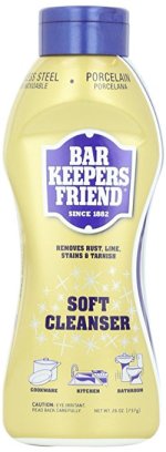

Active ingredient is Oxalic acid. It will shine your brass but be sure to rise real well or it leaves a powder residue.
If it came in a liquid I would use it for sure.
It does! I use it on my kitchen sink...
