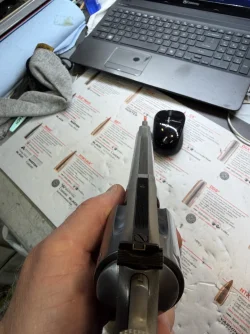

I guess I need to get a picture, but it looks just like all of them if you do a search. If you're looking down the barrel, it's canted to the left. Enough that the ejector rod is not catching well. Like I said, I can adjust the sights enough to make it work. I'm going to buy the frame wrench I guess. I just hate to spend that money for a one time use.

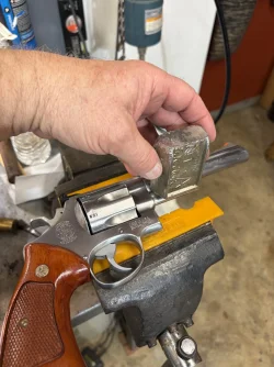

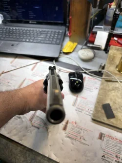

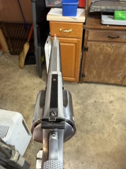

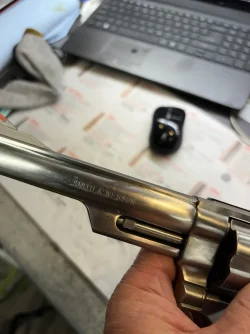

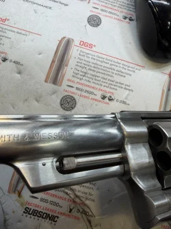

These are after pics. The last pic is how I rotated the barrel assembly with tin babbitt and a small brass hammer without marring or warping anything. The cylinder gap is .003
I spent an hour and 2 boxes of shells yesterday trying to sight it in. Today it took 20 mins and 25 shells.

I have seen a bunch that seemed slightly over clocked, where the barrel lines line up on the left side of the channel for the sight. None as bad as yours and it looks like some material build up against the frame. I wonder if a previous owner didn't think the barrel was loose and put some steel wool threads or something on the threads and then cranked it tight. Anyway looks fine now glad you were able to get it right.
