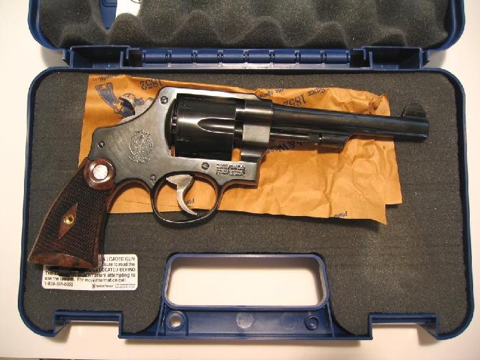

Have this in my stash of 1917 parts. It appears to be NOS. Maybe for a model 1950? Thanks.
You're photos do not show the barrel markings well which are the best clue to what vintage or model it's for.
But as you guessed, most likely a barrel for a Model of 1950 Military (which became the Model 22.)
The rollmark on the left barrel appears normal for a prewar gun, but the one on the right side is odd; the factory left it blank on prewar parts and put ".45 Model of 1950" postwar. Perhaps someone added ".45 ACP" to a prewar part.
The depth and font of the rollmarks appear different from factory; perhaps a refinished/re-marked barrel? Is it 5.5"?
There was a factory in Brazil that made replacement barrels for the 1917s that were made for their govt. I can't remember the name of the company, must be old timers........
