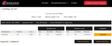

I purchased these bullets for reloading 45 ACP years ago but have recently purchased a Winchester Lever gun in 45 Colt that I plan to reload for. Can I use these bullets for 45 Colt and is it safe to use round nose bullets in a tube magazine? BTW, these Berry bullets are swaged lead core, electroplated with copper.

As long as you aren't trying to load any barn-burners that exceed Berry's max velocity recommendations, then you should be just fine.
If I couldn't find load data specific to that bullet, then I'd start with minimum loads for a similar weight LRN hard cast bullet and work up an accurate load from there.
