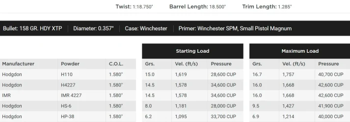

I've used a lot of Berry's plated bullets in handguns and rifles - many in the 38 and 357.
Found that a 20" 357 mag lever action rifle picks up about 400 fps over the same load from a 6" revolver!
So, that's something to be aware of and it is awfully easy to exceed 1500 fps from the rifle, using a 158 grain 357 magnum.
Here's some 18" rifle data from Hodgdon's online data center:
Thanks so much. for that info, Guy M. I assumed you'd get more fps with the rifle but since I don't. have a chrono, I couldn't verify it. I'll definitely keep that in mind when I'm using .357 pistol data for rifle loads.
