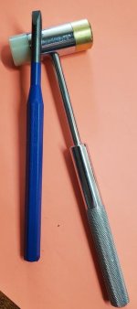

I bought a $6 punch from Ace Hardware and took my Dremel tool to grind the end to perfectly match the surface on the front sight where it is contacted. That took about 15 minutes. I took about 10 light hits and if finally moved. It only took about 5 minutes. I benched it and it improved from 4" left and 2" down to 2" left and 1" down. I will move it just tad more and bench test on Saturday. When I looked at the pushers on Amazon, most had bad numbers for reviews.
The front sight was obviously set too far to the right. I drifted it to the left.
I have not tried to move the rear sight.
