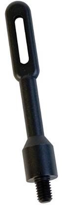

While most of the forum members may already have their own distinct preferences for cleaning equipment, I'm sharing below some information that I have recently discovered. I've been cleaning firearms for over fifty years. In the past seven years I switched back to the Outer's rifle kits. They are inexpensive and have performed well for me. I have a practice of cleaning, lubing, and applying Renaissance Wax to all of my firearms every six months. I follow the same practice after I return from the range for my "shooters". A few days ago I started work on my rifles and the first one out of the chute was my Winchester .30-.30. I screwed in the plastic gun patch jag, used two small patches, and pushed the rod down the bore. Unfortunately, when I attempted to pull the patches back through to the muzzle the tension was too high and the plastic jag snapped off where it connects to the brass rod. It was impossible to remove the end of the broken plastic jag from the rod so that I could replace it.

The plastic gun patch jag was $5.34. Go figure.

In my case I was very lucky. The jag snapped off in the breach as I was puling out the patch back up through the barrel, and the problem was easily corrected. Remove the brass rod - pull the patches and jag out through the breach. However, if that jag had snapped off at any point in that 24" barrel I would have had entirely different, and more complex problems. I'm sure glad that I found these brass jags.

I have not used plastic jags and loops for over 25 years now. The plastic ones never last too long and usually break at the threaded part.
I like the Dewey Brass loops and BEFORE I ever use them I polish off the sharp corners and burrs. I don not think I've ever broken a Brass one.
Plastic will work if not over stuffed with material.
They will stand up to copper cleaners........
I do like the brass tips better but you need to clean them at the end of the job with some bore cleaners.
As for the broke tip........
you can heat up a nail or small screw driver and shove it into the plastic, to cool.
You should be able to remove it in a few minutes with a light twisting. some kroil or oil might be needed if hard set.

The tip about using a hot screwdriver works great. I'm sure it's been done countless times!
I think there is confusion about the term "jag". To me, a jag is not a cleaning loop or visa-versa? Jags are universally used for muzzle-loading guns and are solid brass made in diameters slightly smaller than the bore. Patch wraps around the jag so you do not lose it down the barrel. Patch loops are what are shown in the OPs image and are I would recommend they never be used for Muzzle-loaders, just cartridge guns.
To me brass is ALWAYS preferred over plastic to eliminate the chance of breakage. I don't know why one needs a hot nail to remove a broken plastic loop since you can just push it out? Aren't all barrels other than muzzle-loaders open on both ends?

I went back to the seller site and the plastic model is listed and described correctly by Outer's as a "loop". The other seller with the brass version incorrectly lists their product as a "jag", which according to Gary's post, is incorrect.
I'll check my cleaning rods later. However, they are brass. IIRC, the male end has external threads and is solid. The female end has internal threads. The "loop" snapped off at the threaded end when I attempted to pull it back up through the barrel of my rifle.
