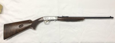

I got a beautiful grade III SA-22 made in 1958, had it 30 yrs or so. Bought a half dozen guns on one of my forays and the wife claimed one, a grade II. I'd had a couple grade I's over the years but sold them eventually, but picked up a japanese model grade I a couple weeks ago. Its a really well finished rifle. I love these things.
Grade III
