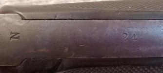

Those proof/s(?) are above the flash-gap on the side of the top-strap. That last one is of the rear of the grip-frame... N 24.

The back strap 'N' is a Royal Navy property marking.
Pretty plain,,but that's what they used both on rifles and handguns.
The '24' would likely be a Rack Number for the weapon.
