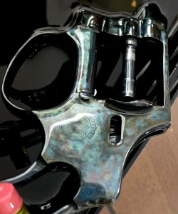

As a continuation of my Model 36 personalization project (phase 1 was "chip flint" stippling the backstrap), I gave the frame a case colored finish.
I'm soaking it in oil for a few hours but snapped a couple of initial pics...
I'm pretty pleased with the result for my first try...I'll post some additional pics later.

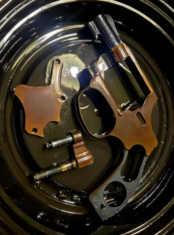

Apologies for the delay...it looked very good with a coat of oil but not great once it dried a bit.
I decided to strip it off and try something different so I applied several coats of BC Plum Brown Barrel Finish to the frame and I'm very pleased with the result which (depending on the lighting and angle) appears chocolate brown/copper to purplish blue.
It's definitely a process with each coat requiring heating to around 250°+, applying the Plum Brown, cold water rinse, carding, and rinsing again. It's easy to see why some aren't successful/satisfied with the outcome since it requires extensive prep and at least 5 coats (I did 7) to even the color, etc.

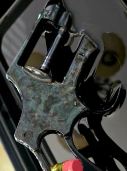

It's currently soaking in some Barricade but here's a quick pic...
Here's another pic which shows the variation in color with different lighting...

To get the case colored look, I started by applying the BC Plum Brown to most of the frame on room temp steel which produces a lighter brown/copper color.
Once that set/dried a bit, I dipped q-tips into BC Super Blue and dabbed them in and around the Plum Brown sections.
The chemicals seemed to mix a bit which created cool variations in color including dark brown/black, copper/bronze, and shades of blue/purple.
I continued to dab the chemical mix around the frame until I achieved the look that I was going for and then I gave it a thorough rinse in cold water.
After that I soaked it in motor oil and let it sit overnight.
Like I said, the result looked great with a coat of oil but upon drying, the colors looked less vibrant.
As you mentioned, I could have tried coating it with a lacquer or other coating but then decided to strip it and Plum Brown the frame instead.
I hope that helps but feel free to reach out if you have any questions.

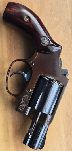

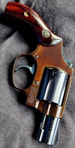

I finished the Plum Brown rust finish on the model 36 frame this weekend and enhanced the color case coloring on the bobbed hammer and trigger.
I had some time earlier today to reassemble it and I'm pretty pleased with the results...I really like how the color looks different with changes in lighting, etc.
Just waiting for a pair of Altamont Bonded Ivory grips and a BK grip adapter to finish it.

I'm glad that I decided to try the Plum Brown rust finish instead...I think it looks great and can't wait to get the black BK grip adapter and bonded ivory grips on it. I updated my grip order to include bronze medallions (instead of silver) which should match the old school look better.
