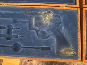

Giving this a try for the first time.
I’ll get a little dremel tool in there and sand some..
I have light blue and royal blue flocking which might need to be mixed to achieve the correct color.
I will post pictures when they are done..
I am not expecting 100% but let’s see how this goes…

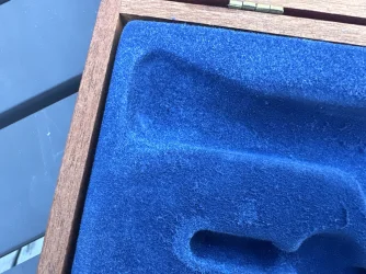

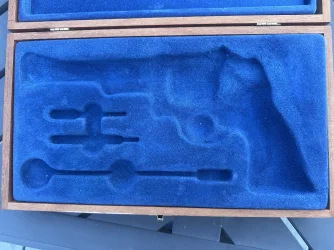

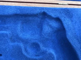

Came out pretty well.
Certainly a learning experience.
Color matching got pretty close.
I used royal blue, navy blue and turquoise.
I might have gotten away with just royal, and navy, but I tried a few.
I did learn that you need to mix the paint color to match as well. I only had the royal blue to start with and I learned that that will not do.
Mixed a bit of navy with it and also learned that painting over existing fibers is OK.
I’m sure it will be a continual learning process, but I’m pretty pleased for a first try.
