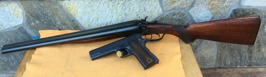

Good idea. The commies know how to make weapons. Here is my combo. The shotty was made in the USSR.
