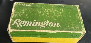

Interesting on the load data and just today, I was visiting a small one man gun shop and the owner has a box of misc. older factory rounds on the counter top and gifted me this opened box of Remington 38 Special 158 lead RN. I reload 38 Special dewc 148 gr. usually 231 3.5 grains for target loads. Looks like original sales sticker $6.60 and no sku number. The 38 Specials look to be in good condition.

So the Green and Yellow box has nickel plated cases with R - P head stamp. I suppose the plated cases might make it a better carry ammo. Otherwise presumable the same load as the G&W Rem box?
