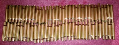

What works much better is Bar Keepers Friend in hot water in a gallon bucket. Dump the cases in, swirl well for several minutes, and rinse well.
Just happened to have some going today. .45 before and after and a tray of .380 just out of the oven.

Okay, so I tumbled some rifle brass this morning in the SS media, so now I can show a direct comparison. These photos compare 30-06 cases... one done in the Hornady Lock-n-Load sonic cleaner, the other in the Thumler's Tumbler with SS media, a squirt of Dawn and a dash of Lemi Shine. I also attached a photo of the entire batch I just ran. I did that all at once. It would have probably taken two batches to do that many in the sonic cleaner.
