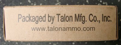

I have some M2 ball purchased years ago from the CMP that was repackaged by Talon and marked as such. This was delinked MG ammo, late 60's LC production. My batch was all headstamped LC 68, loaded with ball powder and shoots OK through my Garands.
Here are some photos of the Talon repackaged M2 ball I received from the CMP. Note the box is marked that the ammo inside is surplus and "not newly manufactured". The ammo itself shows definite markings from the MG links.

It's just LakeCity arsenal Milsurp ammo. late 60's mfg.
CMP hired the outfit to most likely strip the stuff from MG links and repackage for general sale.
MG links/linked ammo are considered 'hi-cap' magazines under many state laws that ban such. So selling linked ammo is a smaller market for the CMP than just boxed ammo.
I can't figure why some $5.00 hr kids de-linking and repackaging the stuff into 5cent recycled cardboard boxes makes it somehow unsafe.
Maybe if it just had the CMP logo on it, there wouldn't be any rumors & suspicions.
That is LC head stamped M2 Ball. i would not worry too much about it being good for a Garand.

I bought several ammo cans of the ammo pictured from the CMP North Store 10 or 15 years ago. It was sold by the CMP as Lake City surplus ammo. I don’t think they were lying about it.
The stuff always shot fine for me, I still have a couple of cans left. It was $0.20 per round back then, and service grade Danish and Greek return Garands could be had for $279. Who would have thought the good old days would end so quickly.
I may be mistaken but I believe the 30.06 ammo was sold by the government as components and Talon reassembled those components, primed case, powder and bullet back into live rounds. I got some in a trade years ago and had some duds and hang fires.
