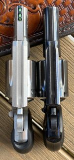

I have a 1953 Cobra, 1974 Detective Special and a 1st gen Diamondback plus a new Cobra and 3 new King Cobras. The D frames are all the same size as far as I can tell. My Detective and 1953 Cobra look exactly like the new Cobra. Like the various generations of Cobras and Detectives the grip frame was shortened and squared around 1966 and grips appear to be compatible with the new models but would need to try them.

I did a side by side comparison of my 1953 Cobra and my 2017. They are identical in size. I opened the cylinder and placed it against each other and they’re the same. Frame to frame they’re the same size also.
My 3” King cobra cylinder was also the same but the KC frame is approximately 1mm shorter in length looking at the top straps lining up and seeing where the barrels screw into the frame.

I did a direct comparison that you can see with your own eyes.
The first photo is the cobra on top of the DS.
The second is the DS on top of the Cobra.
The third is a side by side.
The fourth is from the top.
The top strap of the Cobra seems a little beefier than the DS but nothing I ever noticed and don’t think most folks would notice. The cylinders are the same length and diameter. Both guns appear to be the same size as far as I can see.
