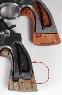

I’m sorry if this question has been asked before, but my Google-Fu is not getting me an answer.
I have a we if N frame round to square conversion grips. I’d like to use them on a square butt, so would it be as simple as cutting this little triangular piece out?
Maybe make a cheap plaster mold?
It's a long around the barn, but you don't fubar a good grip.
After you have a plaster version of the grip, you can play, er research, with the cut outs.
For the record, the pic was just grabbed off the internet, not my gun.
Mine is a 25-9 with Eagle conversion Heritage grips. I’m going to try the square butt grips on a round butt test as suggested above and see if that gives any insight.
I’m surprised no one’s chimed in with actual experience with this, that’s possibly a clue.
I think it would work. I have taken square butt grips and put them on a round butt revolver. To fill in the gap at the bottom, I simply cut a small triangular piece of wood and shaped it to fit.
Well…. I did it with a set of Altamont “Cokes” and it worked fine so it can be done. The Eagle Heritage are not cheap and I would be a little more nervous with them. I believe I would try to sell them and buy another proper set for your square butt gun.
You might try laying the pistols, without the grips on a piece of paper and trace around the grip frame. then cut on the lines and compare them, against each other and and the frames. Maybe that will give you a better idea.
Original target grips are getting too expensive to go chopping up. Just buy a set of grips to fit the gun.

I actually tried for about half of what I paid, no takers, so it's time to make some
They're not original but they are too expensive!
At this point they're almost worthless to me as I've got no takers for them on the ad, and I just use combats on round butts these days. So, if I can make a single cut and they work, now I've got some nice grips for the square butts I own.
